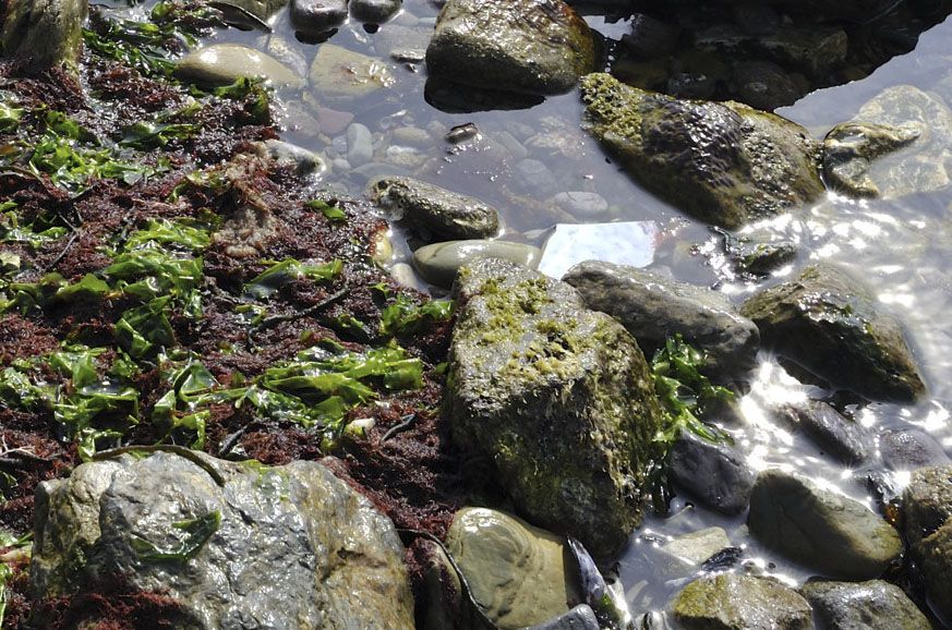

And then, I have samples to share/ask opinion. I guess the below sample is like a mixed salad (please excuse the quality of the image, but I believe it's an appropiate sample to bring in <img src='http://forum.photozone.de/public/style_emoticons/<#EMO_DIR#>/smile.gif' class='bbc_emoticon' alt='
' />...). It's a 100% crop. Taken by the old 135mm CZJ Sonnar @f/3.5. The rocks look slightly OOF (maybe because it's a native M42 mount lens, which is unable to focus at infinity on Nikon). Check the blue surroundings on the left-bottom. Any ideas?... Or the purple halos all over the image, they look like BF but there are more purple halos towards the rocks (near to the in-focus area) and that confirms PF I guess...
![[Image: _SKT9812_019_NX2_sample.jpg]](http://i1172.photobucket.com/albums/r571/SerkanKet/Test%20Shots/_SKT9812_019_NX2_sample.jpg)

You will only see that kind of "ghosting" as you labeled it surrounding very bright spots, simply because that is the only part where the light is strong enough to reflect back in enough quantity. For the rest of the image one would only see a light contrast lowering.
The 28mm f11 image... well, first of all you shot it at f11. This will mean that the light is of MUCH lower intensity, so much less light will reflect back.
