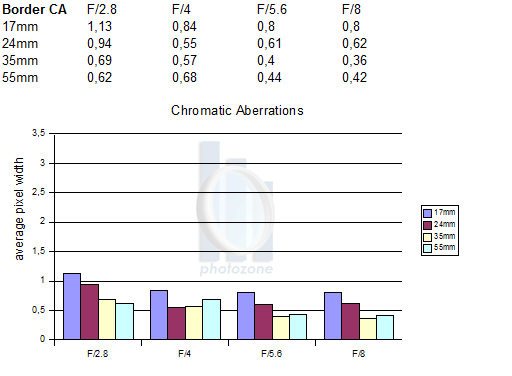

Canon EF-S 17-55 IS USM:
"Chromatic Aberration
CA is a bit of a weak point for this lens, at least at its widest focal lengths. At 17mm, maximum CA is quite high, although average CA is much lower, indicating that the worst CA is limited to the edges and corners of the frame. CA decreases as you zoom to longer focal lengths, reaching a reasonable level (but still higher than we'd like) at 28mm. CA from 35-55mm is acceptably low."
"The Tamron has better CA (sometimes much better) across the focal length range"
In reality, this lens has very low CA.
Photozone (correctly) finds:
"Lateral chromatic aberrations (color shadows at harsh contrast transitions) tend to be a weak spot of most zoom lenses in this range but the EF-S 17-55mm f/2.8 USM IS produces an unusually moderate degree of around 1px at the image borders."

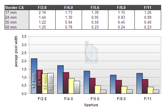

About that Tamron that has "much better" CA across its focal range, photozone (correctly) finds:
"Chromatic aberrations (color shadows at harsh contrast transitions) are high towards the wide-end of the zoom range especially at large aperture settings with a peak of almost 2.2px on the average at the image borders at 17mm. Stopping down reduces the issue but you will need to stop down to f/8 in order to suppress the problem to an uncritical level at 17mm. CAs are a lesser problem towards the long end of the zoom range."
![[Image: ca.png]](http://www.opticallimits.com/images/8Reviews/lenses/tamron_1750_28_d7000/ca.png)
Checking any non-corrected images from each lens confirms this.

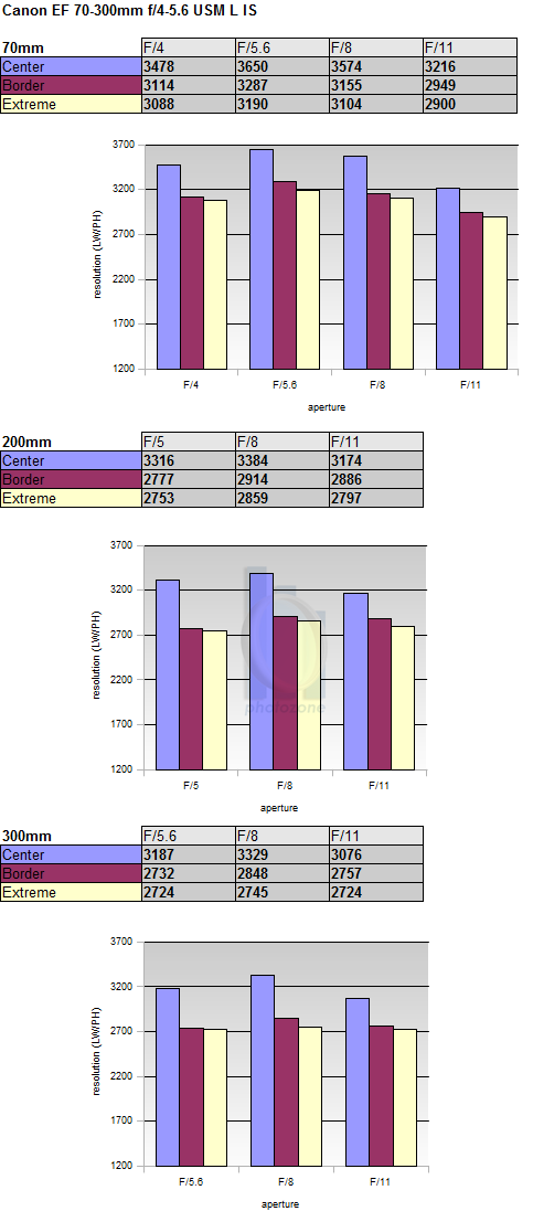

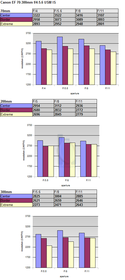

According to SLRgear, the Tamron 70-300 VC and Canon 70-300 IS are sharper than the Canon 70-300mm L IS USM:
"It also offered slightly better results for sharpness" (canon)
"Despite the dramatically lower price tag, the Tamron actually produced as-sharp or sharper results than the Canon."
70-300 L IS USM:
![[Image: mtfx.png]](http://www.opticallimits.com/images/8Reviews/lenses/canon_70300_456lis_ff/mtfx.png)
70-300 IS USM:
![[Image: mtf.png]](http://www.opticallimits.com/images/8Reviews/lenses/canon_70300_456is_ff/mtf.png)
