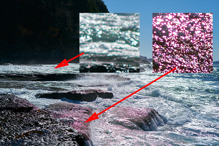

Quote:My vote goes for purple fringing! I've had similar problems in the past, CA sliders can help in ACR, it appears on one side of the droplet!
Confusing line, sorry.
I get the 1st part, your vote goes to purple fringing.
Then?? CA sliders can help in ACR with this image? How do you know? And CA is.. CA, not PF?
And what appears on one side of the droplet, exactly?
Sorry that I am not clear on what you refer to in the different parts of that line... :unsure:
I see the magenta on all edges of droplets in front of the focal plane. Behind the focal plane, same bright droplets, no purple or magenta to be seen. However, we see green instead on the edges of the bright parts.
And regarding PF: it too can appear in all edges of a very over-exposed part. Only lateral CA appears on one side of bright (actually contrasty edges, not specifically over exposed parts).
So, yeah, all the hallmarks of Longitudinal CA...

I can't see anything now the image has gone, nonetheless I've had similar purple fringing in water highlights, when blowing up to 200% the fringing is on one side of the droplets, using the purple/green CA sliders in ACR the purple can be reduced sometimes to very little, however I didn't see any green in that image nor have had greens in any of mine.

This image?
http://photozone.smugmug.com/Sony-FE-50m...C00803.jpg

I have added a comment about this image to the review.
http://www.opticallimits.com/images/8Rev...8/loca.jpg

Yes, and the magnification works!
Ok you call that magenta fringing BC, I would have settled for purple, due to extreme contrast, I see it every now and then with reflections of the sun on water. I use ACR 9, the manual sliders (for purple/green and their sub sliders from brown to blue) to reduce that, I have reasonable success, sometimes though it doesn't work well.
Whatever, the fringing in this shot is horrifically dire and overwhelming, whether it could remove it is doubtful. Normally green fringing would be behind the point of focus!
Edit. Klaus just slipped his post in between my reply and BC's. I guess there is some green fringing though it's a heck of a lot less obvious. Looks like the LOCAs theory stands!
I'd bin that Sony lens!
